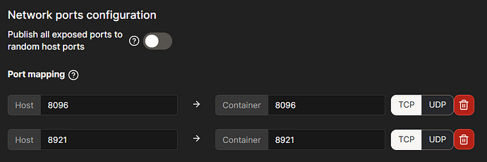

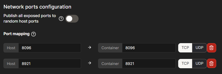

I installed Portainer and have installed several things through it, instead of the Ugreen docker app. I’ve not installed any of the containers you’re trying to install though, but I have Immich, Zoraxy and Jellyfin up and running just fine.
As for your networking woes, did you bridge the connections and open up the right ports?
This is from Portainer.

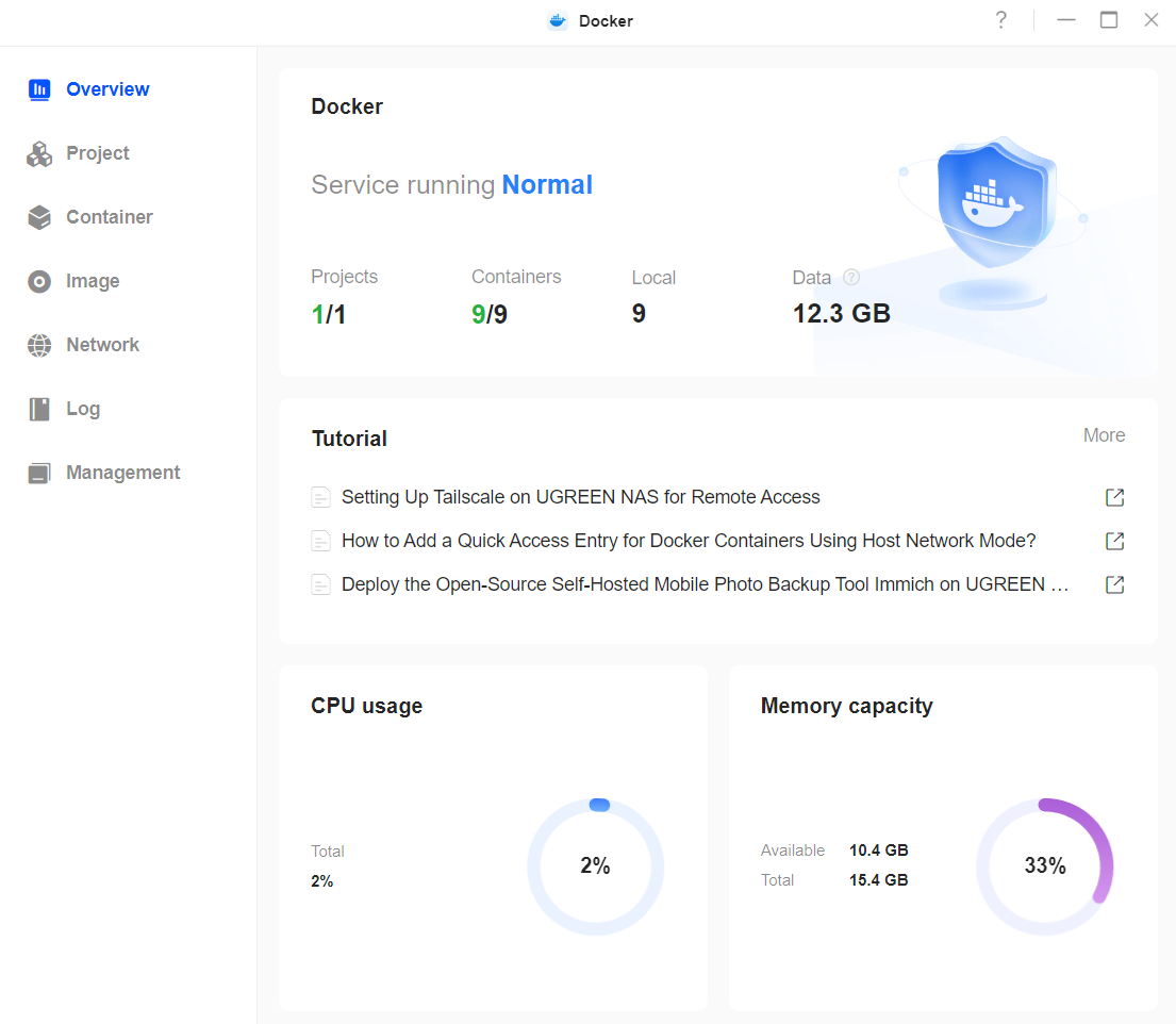

This is from the Docker app

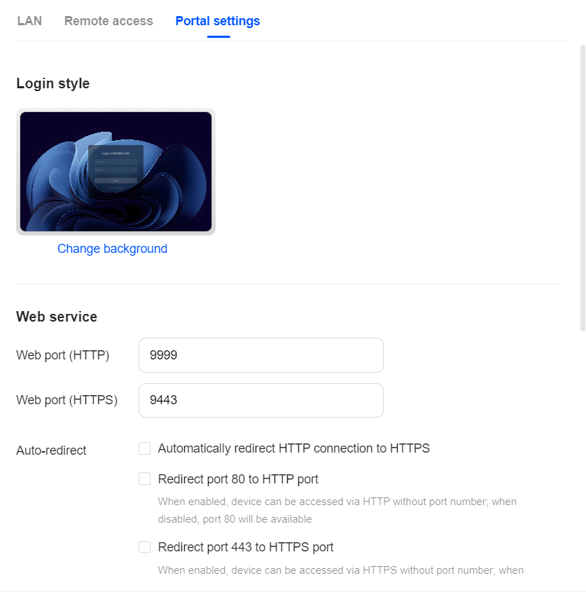

One other thing that might be worth doing, at least if you install something like a reverse proxy, is to disable the automatic redirects of port 80 and 443 to the NAS UI. Otherwise you should be able to point all other things that requires either of those ports to a different port without any issues.
