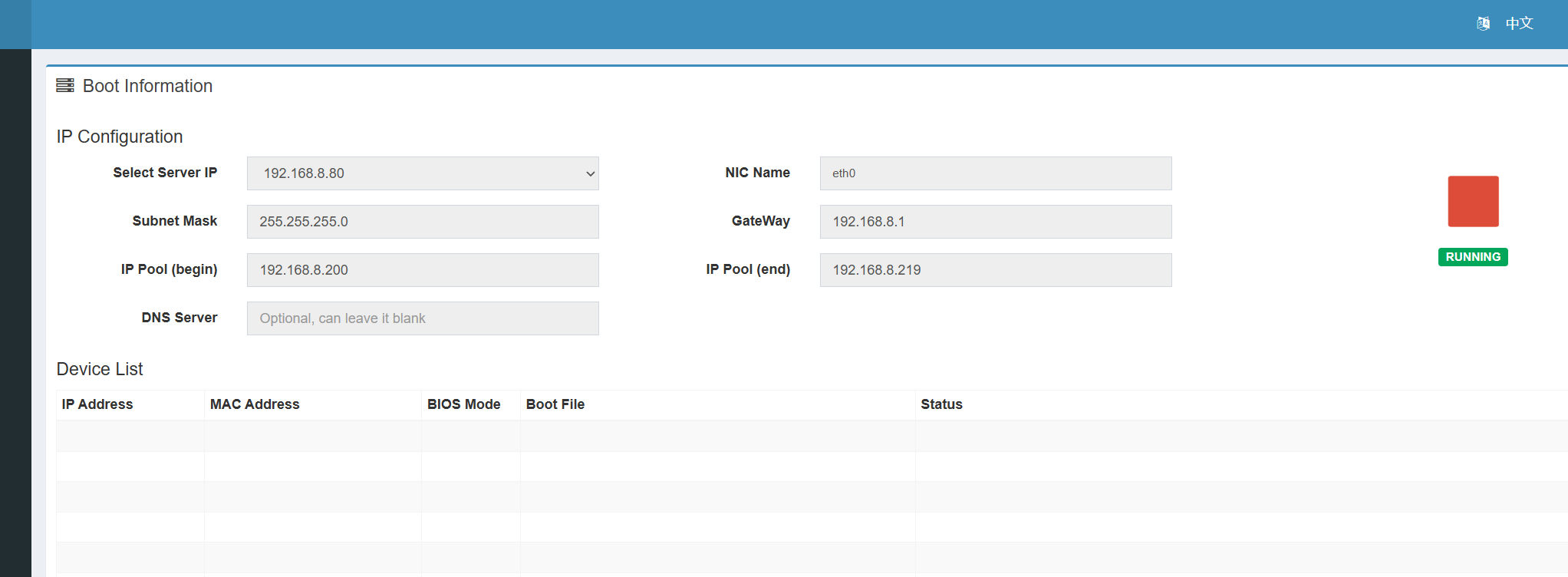

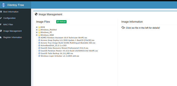

Best working iventoy setting (no conflict) using mcvlan network✅
Hi :blush:

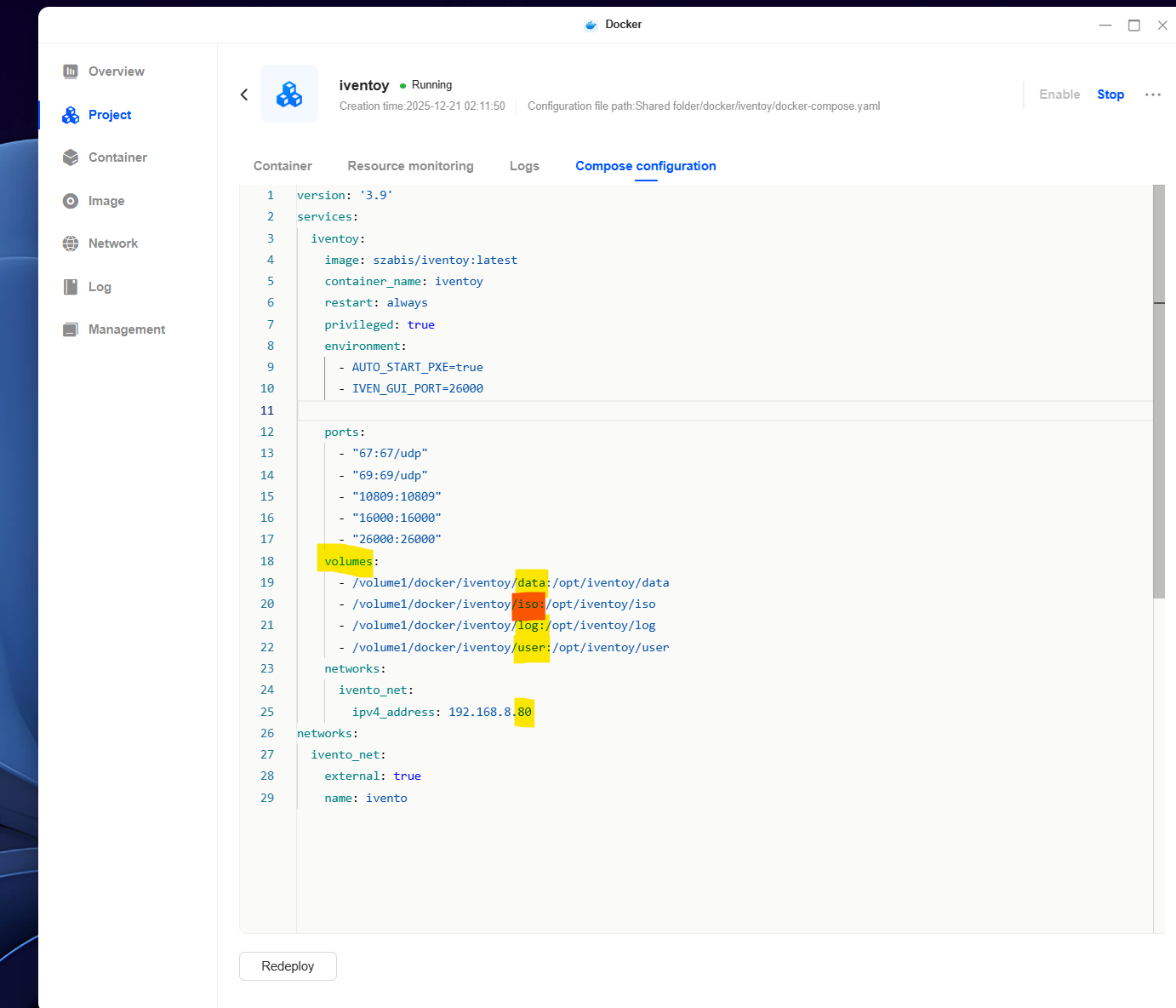

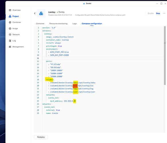

here is my best yaml setting for iventoy using mcvlan network

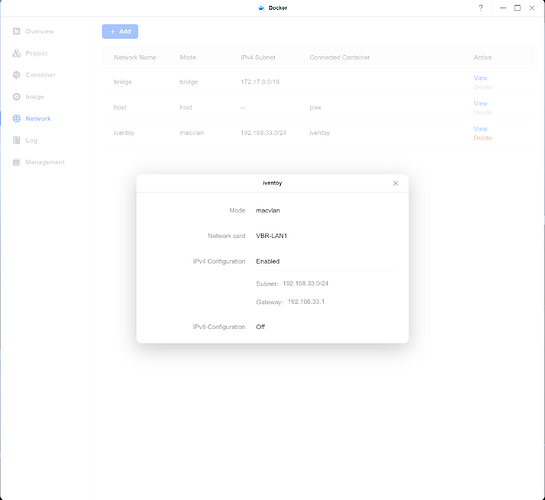

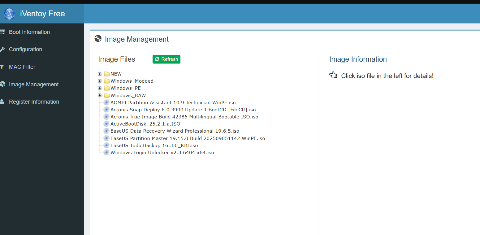

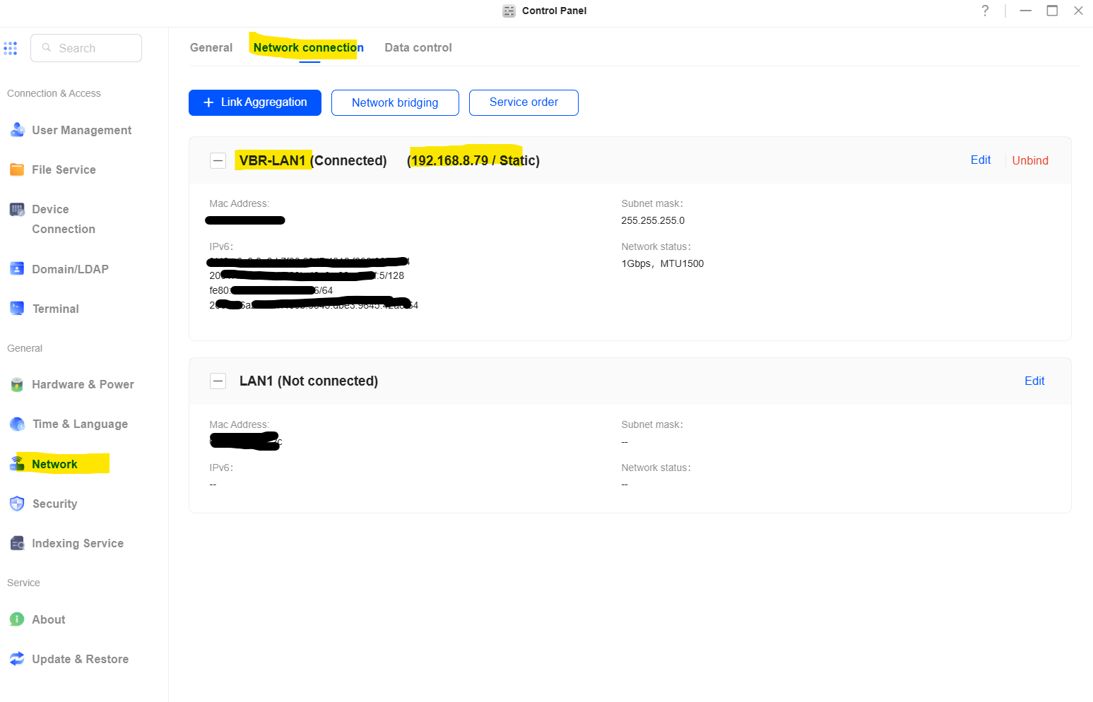

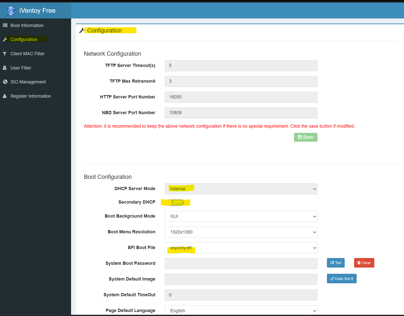

1 - network connection LAN should be VBR mode as shown in pic
2 - create Mcvlan network as shown in pic
3- create folders as volumes in yaml

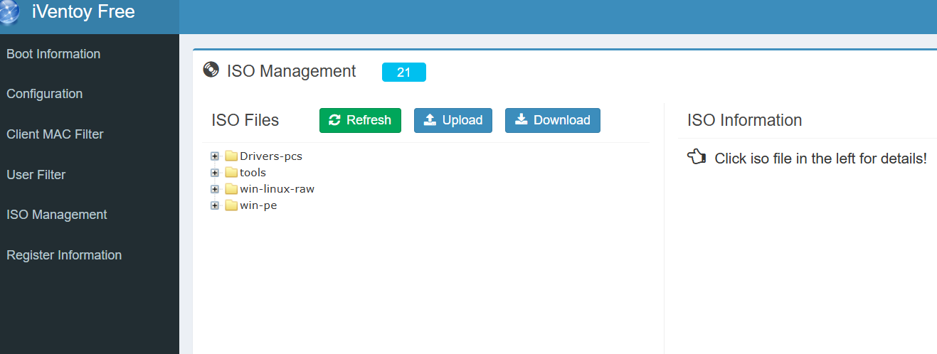

4- copy all iso in iso folder as yaml
-5 ** assign any IP that works with your network conf. and it should not the same as your nas IP
6- paste yaml in docker
now u have working PXE in your network :+1:
version: '3.9'
  iventoy:
    image: szabis/iventoy:latest
    container_name: iventoy
    restart: always
    privileged: true
      - AUTO_START_PXE=true
      - IVEN_GUI_PORT=26000
    ports:
      - "67:67/udp"
      - "69:69/udp"
      - "10809:10809"
      - "16000:16000"
      - "26000:26000"
      - /volume1/docker/iventoy/data:/opt/iventoy/data
      - /volume1/docker/iventoy/iso:/opt/iventoy/iso   #iso files
      - /volume1/docker/iventoy/log:/opt/iventoy/log
      - /volume1/docker/iventoy/user:/opt/iventoy/user
    networks:
      ivento_net: #the name of macvlan i created in docker network
        ipv4_address: 192.168.8.80  # change it to the one you like but not same nas ip
networks:
  ivento_net:
    external: true

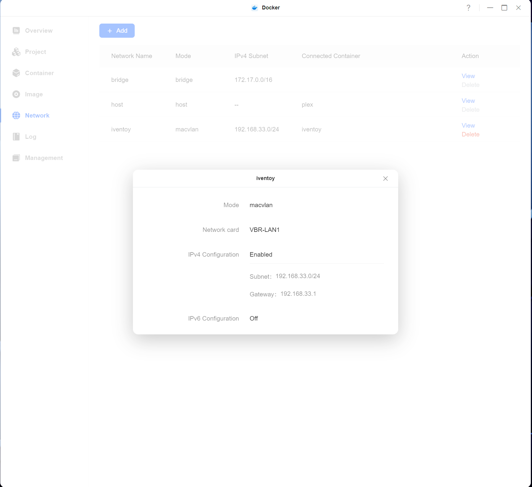

2 - create Mcvlan network as shown in pic, there is no pic of the macvlan

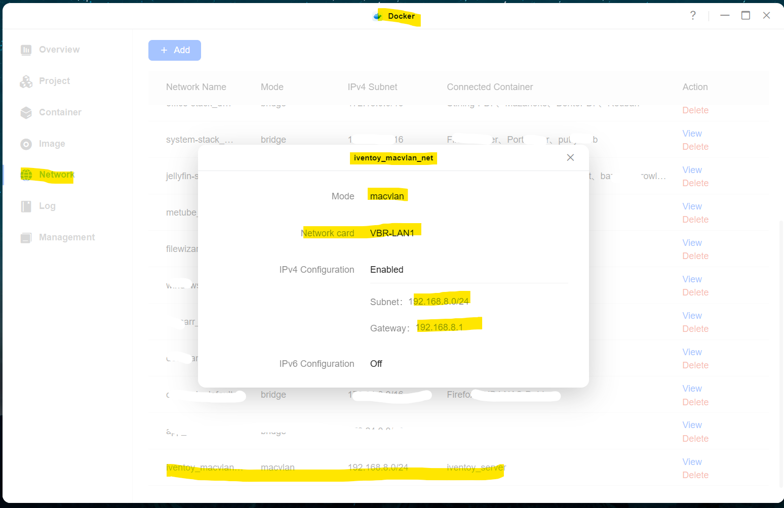

networks:
iventoy_macvlan:   #here you should make mcvlan in docker network setting before start the service
driver: macvlan
driver_opts:
parent: bridge0
ipam:
config:
- subnet: 192.168.8.0/24
gateway: 192.168.8.1

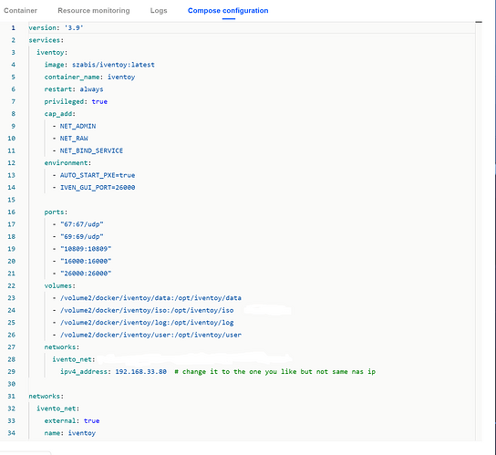

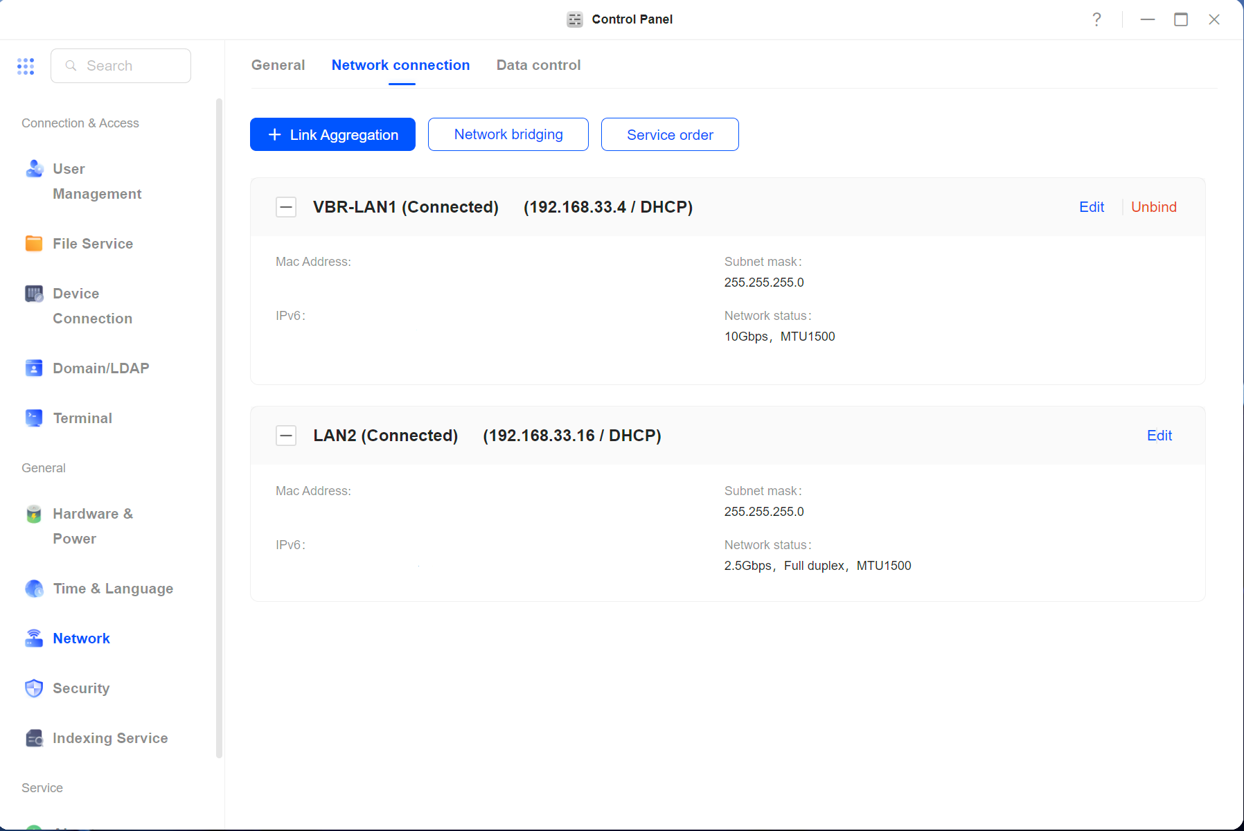

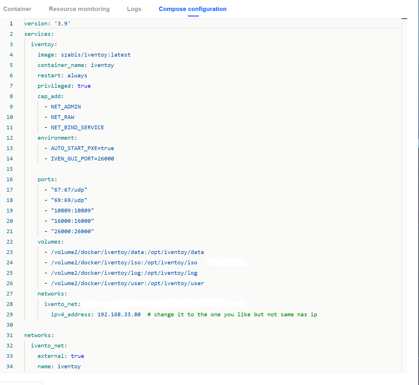

Finally got this working using the following compose file…
version: ‘3.9’
iventoy:
restart: always
privileged: true
cap_add:
  - NET_ADMIN
  - NET_RAW
  - NET_BIND_SERVICE
ports:
  - "67:67/udp"
  - "69:69/udp"
  - "10809:10809"
  - "16000:16000"
  - "26000:26000"
  - /volume2/docker/iventoy/data:/opt/iventoy/data
  - /volume2/docker/iventoy/iso:/opt/iventoy/iso   #iso files
  - /volume2/docker/iventoy/log:/opt/iventoy/log
  - /volume2/docker/iventoy/user:/opt/iventoy/user
networks:
    ipv4_address: 192.168.33.80  # change it to the one you like but not same nas ip
networks:
ivento_net:
external: true
That’s GREAT
now we have 2 working ideas :ok_hand:
THANKS
