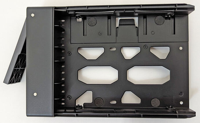

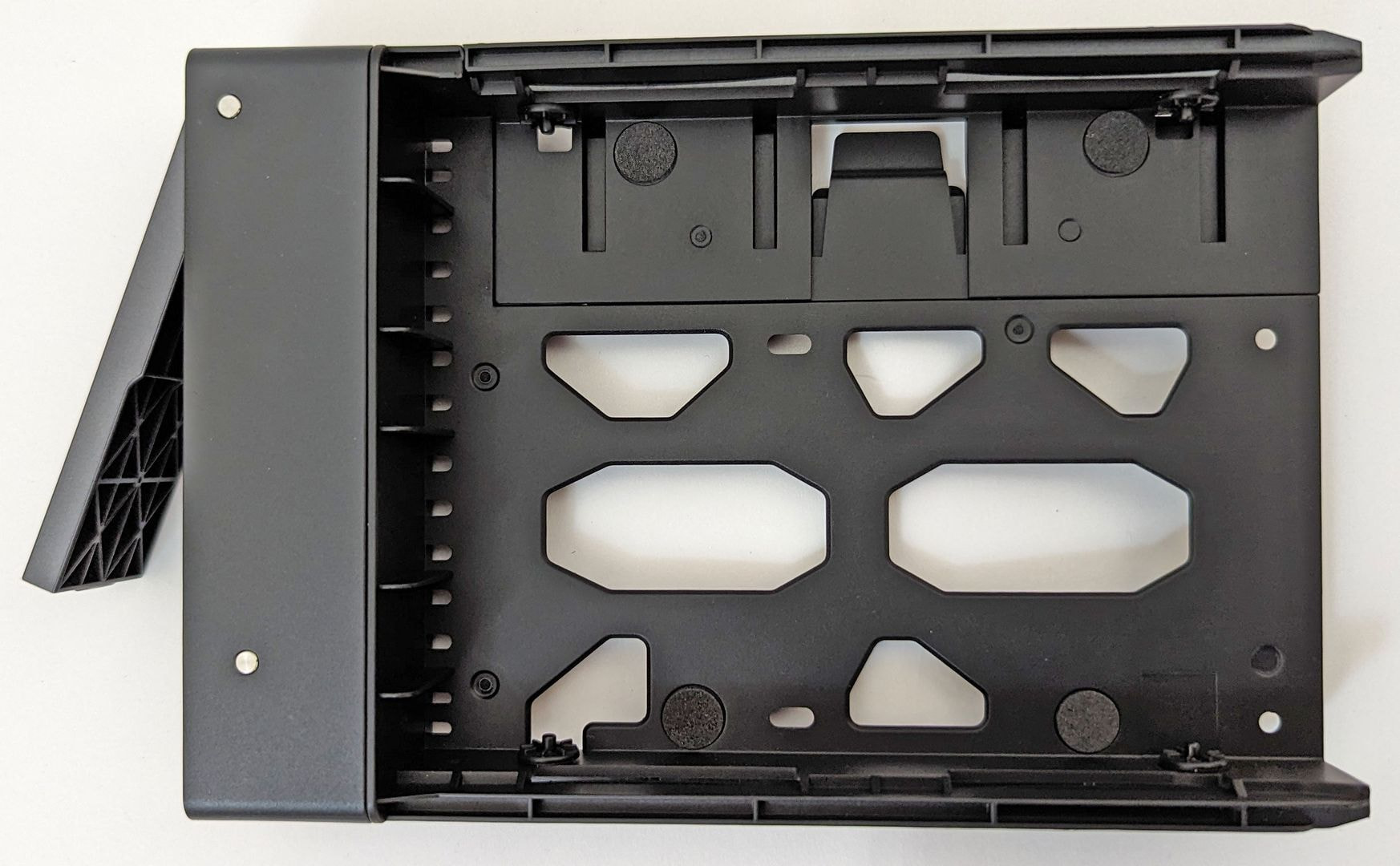

The Ugreen drive trays are very well made and provides decent noise insulation.

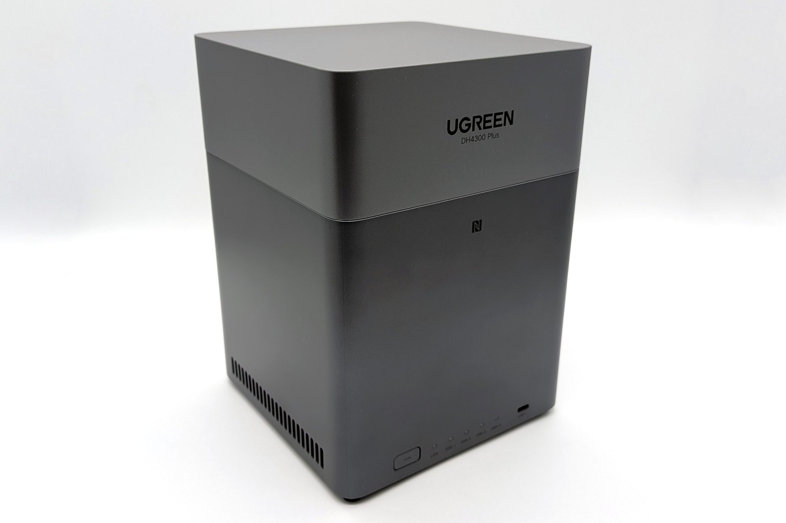

Personally, I wouldn’t bother with their Arm based hardware, as they picked hardware that isn’t that well supported by mainstream Linux, which could mean poor software support in the future. I don’t think it’ll be much quieter, although it lacks the small CPU fan, but the 120 mm fan is placed in an odd location that is likely to see it run at higher speeds, due to it being slotted in between the PCB and the drives. See pics here:

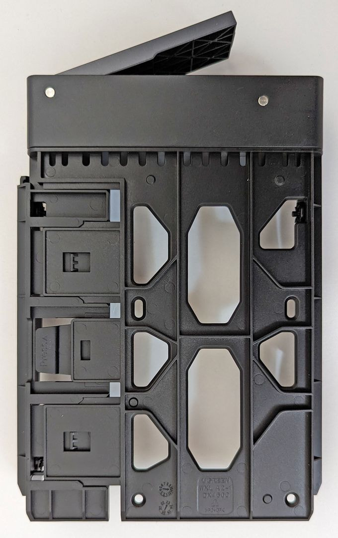

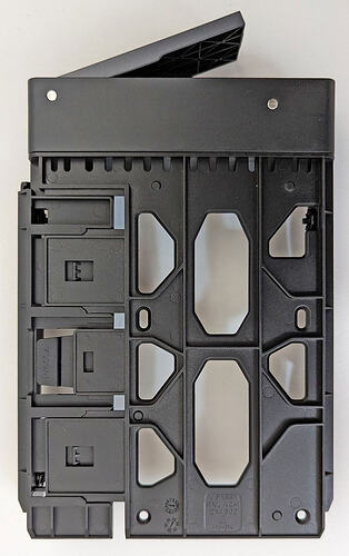

The DH models also have drive trays that require you screw the drives in place.

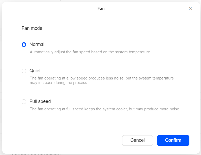

That said, you have to option to change the fan settings via the OS.
Below are my idle fan speeds.

Oh, there’s no resonance, the drive caddies have dampening, so that’s fine.
