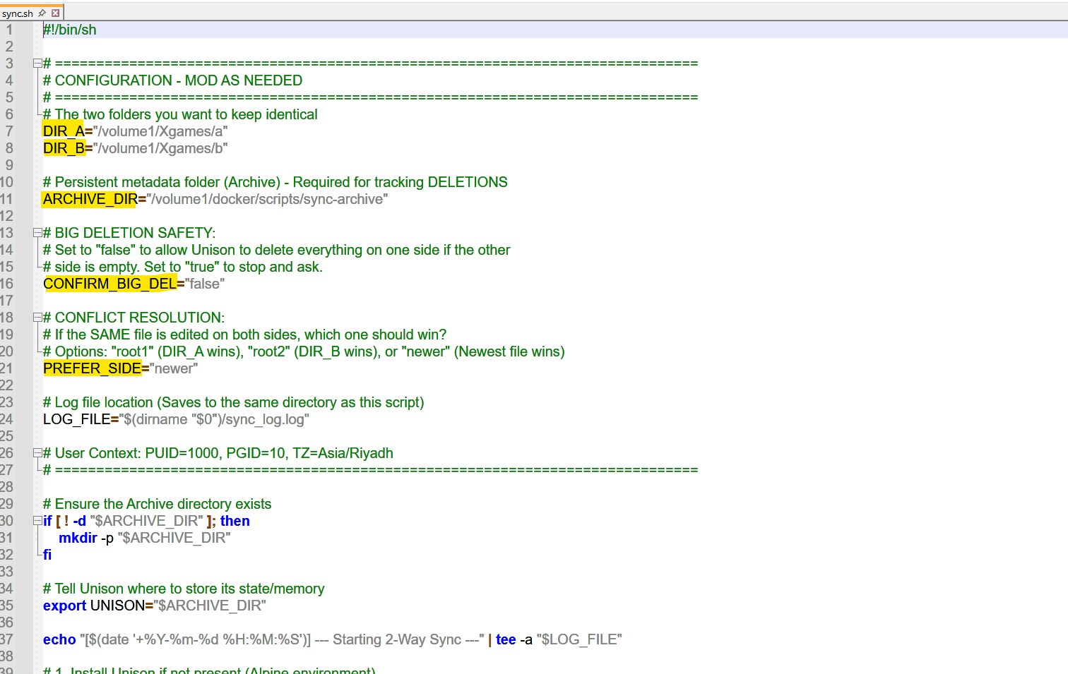

sync.sh
#!/bin/sh
CONFIGURATION - MOD AS NEEDED
The two folders you want to keep identical
DIR_A=“/volume1/Xgames/a”
DIR_B=“/volume1/Xgames/b”
Persistent metadata folder (Archive) - Required for tracking DELETIONS
ARCHIVE_DIR=“/volume1/docker/scripts/sync-archive”
BIG DELETION SAFETY:
Set to “false” to allow Unison to delete everything on one side if the other
side is empty. Set to “true” to stop and ask.
CONFIRM_BIG_DEL=“false”
CONFLICT RESOLUTION:
If the SAME file is edited on both sides, which one should win?
Options: “root1” (DIR_A wins), “root2” (DIR_B wins), or “newer” (Newest file wins)
PREFER_SIDE=“newer”
Log file location (Saves to the same directory as this script)
LOG_FILE=“$(dirname “$0”)/sync_log.log”
User Context: PUID=1000, PGID=10, TZ=Asia/Riyadh
Ensure the Archive directory exists
if [ ! -d “$ARCHIVE_DIR” ]; then
mkdir -p “$ARCHIVE_DIR”
fi
Tell Unison where to store its state/memory
export UNISON=“$ARCHIVE_DIR”
echo “[$(date ‘+%Y-%m-%d %H:%M:%S’)] — Starting 2-Way Sync —” | tee -a “$LOG_FILE”
