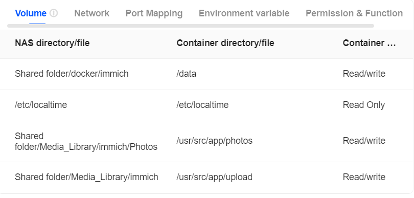

You’re aware that you have to set pointers in Docker to your RAID drives, right?
Otherwise the Docker program won’t know how to access the drives.
Below is an example from my Immich container. You’ll have to read up on the specific container to see what the container directory/file is, whereas the NAS directory/file is up to you to point to the location where you want the data to be or where it already is located.
Thanks for the tip. Did not know that, new to Docker also. Doing a lot of reading.
