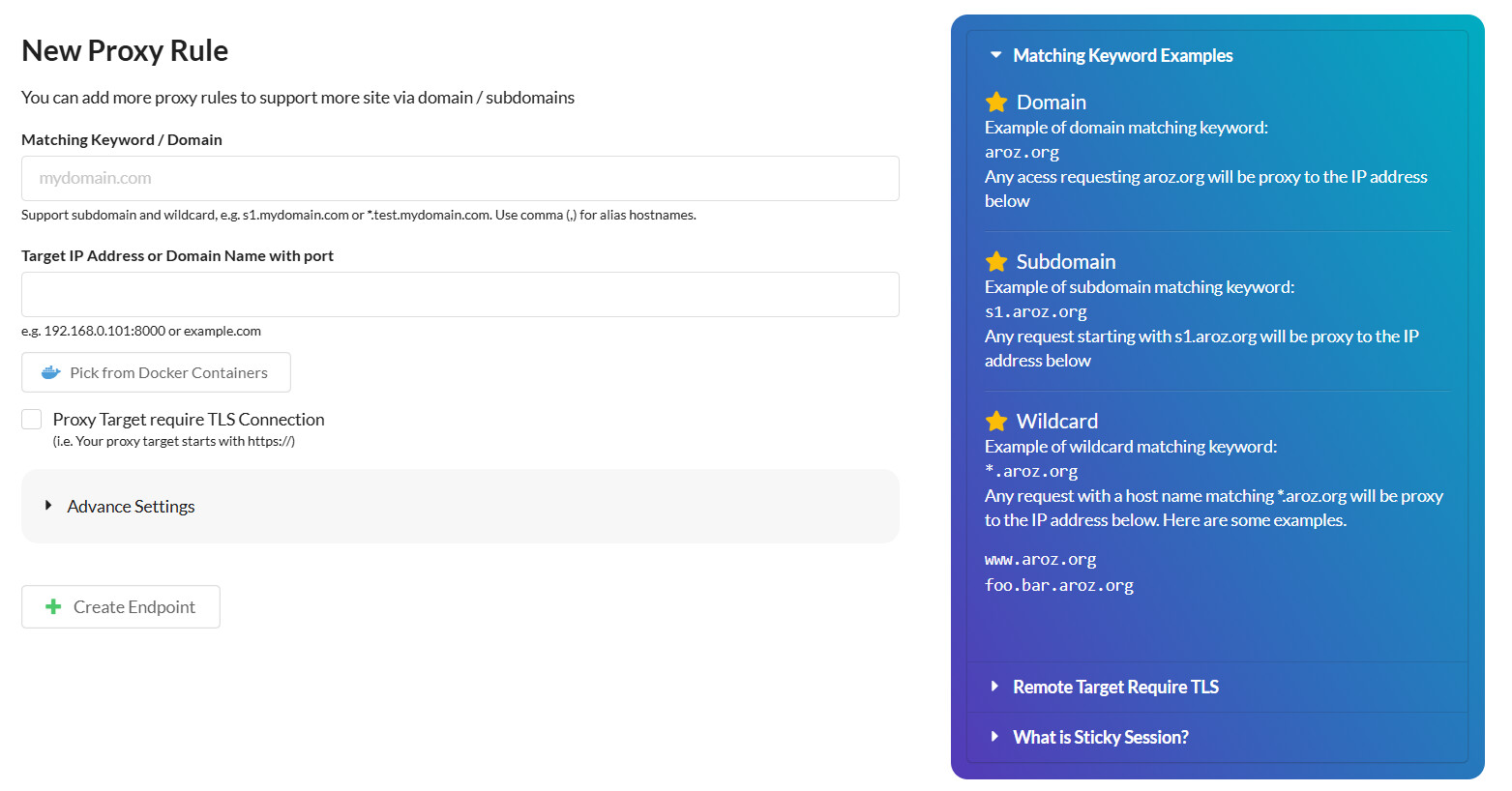

I ended up setting up a reverse proxy using Zoraxy (installed via Docker) which is a great way access something like Immich running on your NAS.

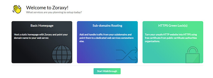

The nice thing with Zoraxy is that it’s very user friendly and walks you through the entire process and it can also be used for hosting a simple website on your NAS. It has a nice step by step wizard that takes you through the few steps you need to do to get up and running.

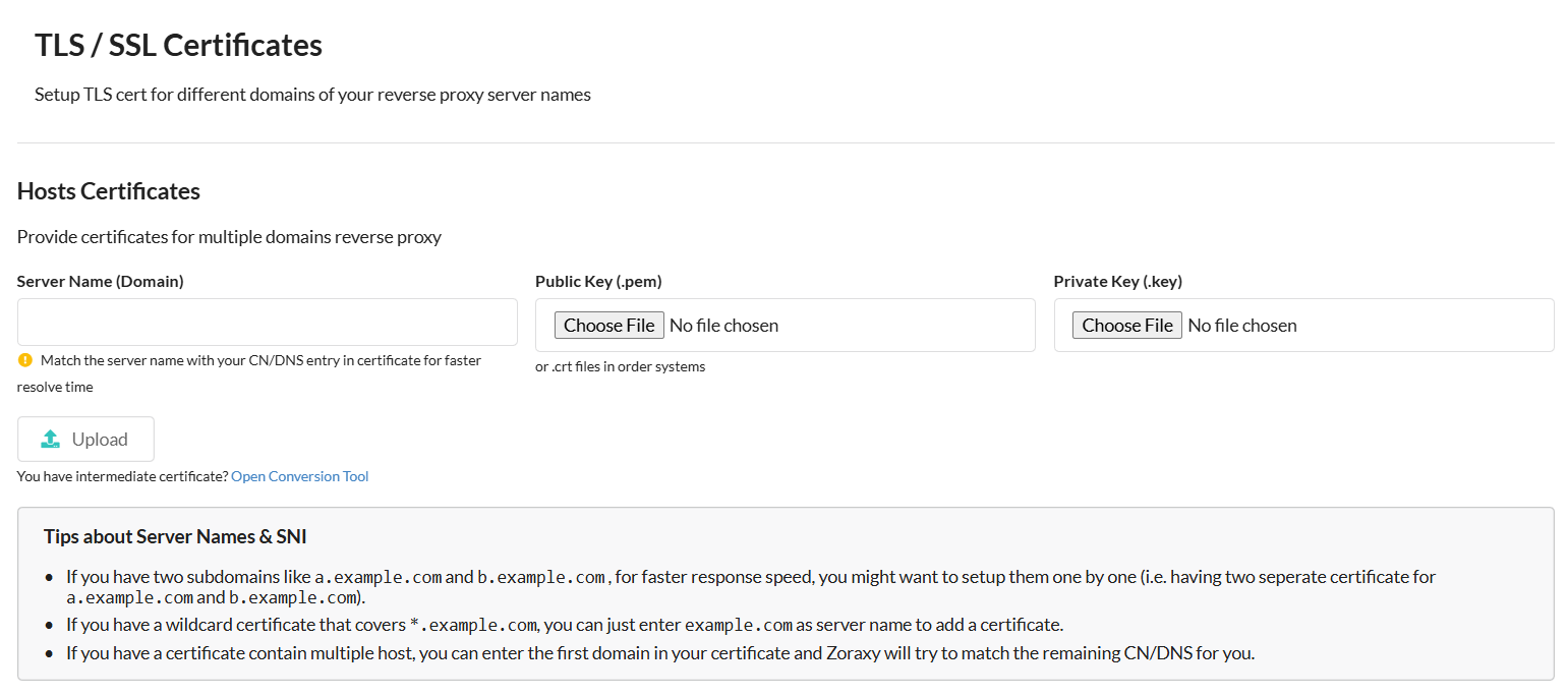

The reason you need to open port 80, is so Zoraxy can renew your TLS/SSL certificates, as Let’s Encrypt requires port 80 to communicate. This took me a while to figure out and was a bit of a pain, since this isn’t really documented anywhere. The port forwarding in your router should only include the external port, the protocol (TCP should be enough) and the IP address of your router and whatever you want to call the service. You should not add an internal port, nor a source IP address.
